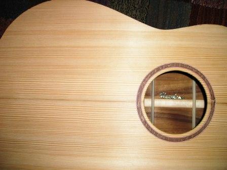

The concensus around here is a mix but I think it will look pretty cool when it is strung up....
I plan on keeping this one. The Top is addy from a factory beam that stood for 75 yrs (I believe....got it from Steve @colonial tonewoods) the backs and sides are Koa from a bar that came from a hotel that was tore down in the 20's in Hawaii and the neck will be from a bar top from a Daryl's resturant that was here in my area for about 23 years.....Hope it sounds good!!

A nice, original touch, I think. Good one, Brian.

Cool!

Hi Brian:
Looks good. Will you be able to see it though, when the strings are on? How about a picture when strung up? I personally like innovations that people use to make their guitars unique. Keep up the forward thinking, Brian.
PostPosted: Thu Sep 29, 2005 11:46 am
Brian, is it inlaid?
I like it, I think? Id like to see a view a little further out --

   This is a great little guitar. Love the history. A real Toast to your skills.

I like it a lot. I may copy that. I think it would look cool to have Hawkins inlayed into the back of my own guitars.
With all that history I hope the guitar is not haunted.
BTW, VERY nice rosette!!

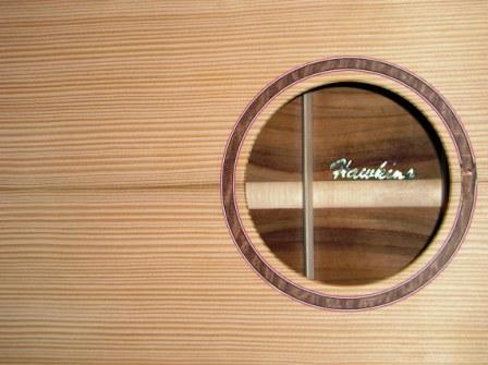

Thanks....here is a pic from further back. I haven't done the binding yet. Lance, it is not inlaid. It is a very thin (.009 in) abalone...CA'd. If I like the way it looks when it is finished I will go with it inlaid but for this time I would call it a slightly expensive sticker.

You are more than welcomed to use my name John.....but it won't increase sales for you .....if that wood could talk imagine the stories it could tell!!

I like it and think its a very cool idea. With all that history in the wood, I'll bet it sounds great !

By the way I like inlay, but would prefer it on the back graft. Much better than a label anyway.

Do you cut yout own inlay for your name?   Nice job. To Colin's point, I wonder how some black shell would work out on the center seam brace. Now you got me thinking - I might try it on the one I am building now.

[QUOTE=Brian Hawkins] Thanks....here is a pic from further back. I haven't done the binding yet. Lance, it is not inlaid. It is a very thin (.009 in) abalone...CA'd. [/QUOTE]
Brian,
I, too would like to know just how you managed to cut that ab veneer so well. When I tried, the stuff just fell apart, flakes going every which direction. I was assuming it was just too brittle in that thin dimension. Did you soak it, or what? Cut with an exacto?
Any light you could shed....
PostPosted: Fri Sep 30, 2005 4:35 am
Posts: 408
Well,
My secrets are all out now....They are called "Thin Logos" and you can get them HERE for about $14 a name. They are extremely brittle and will break if you just look at them the wrong way. Applying them is somewhat of a trick, use clear scotch tape and CA glue. If I like the way this looks when it is finished I think I will stay with it as a Label (I will inlay it although it is hard to tell that it isn't). I do not know how they cut them being that they are so thin but I am guessing some type of lazer tech.

Brian, I like the idea but might consider putting the logo on the backstrip. Might also be a good place to put your web address as it would be an attention grabber.

Hey Don, I have thought about the backstrip......but never thought about putting the web address there though!!
